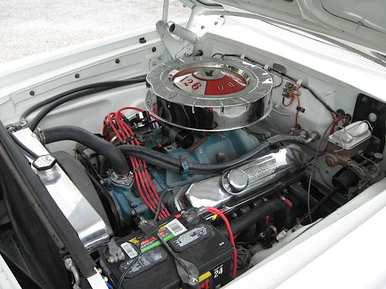

I installed a Vintage Air system in my '64 Polara last year and posted a thread of what I had done with pictures on the '62-'65 Forum. It is about 8 pages in, now. I left the Alternator and Power Steering pump locations unchanged, though. There is a mount kit available from Vintage Air. Since my car had already had a factory A/C system on it, I already had the required pulleys and alternator mount brackets. Hope this helps.

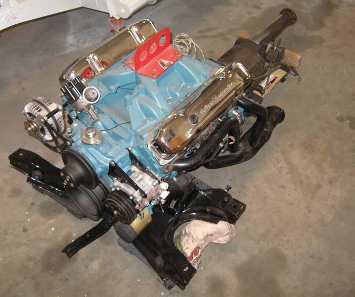

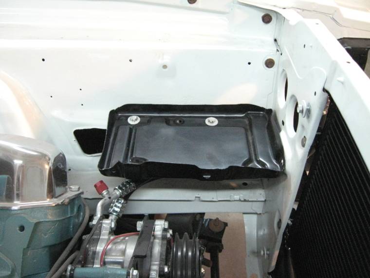

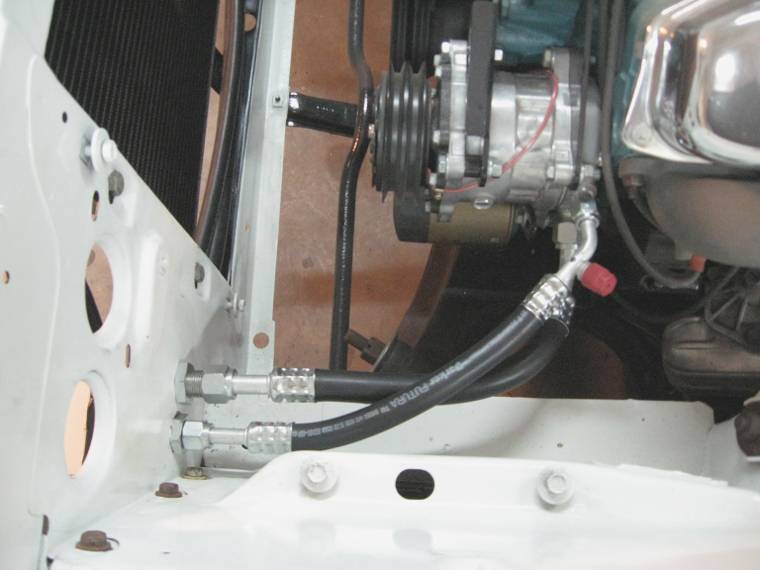

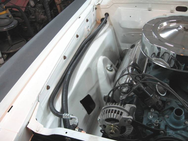

Here's a pic of the 440 that's now in my '64 Polara. The AC compressor is located where the power steering pump would normally be. I have manual steering on this car and this works pretty well. These brackets are available from https://www.bouchillonperformance.com/

I saw that once and the a/c comp. was mounted below the alternator down low closer to the frame rail. The alternator stayed in the stock position. It was a vintage air system if I recall correctly and don't know what mounting brackets were fabricated to do it though
I like the way you wrapped the ac lines in front. Looks good! I’m just thinking if it’s possible to mount the ac compressor where the alternator is, it would eliminate that. And if the alternator is where the ac compressor is, it would eliminate the that wiring on that side of the engine bay.
