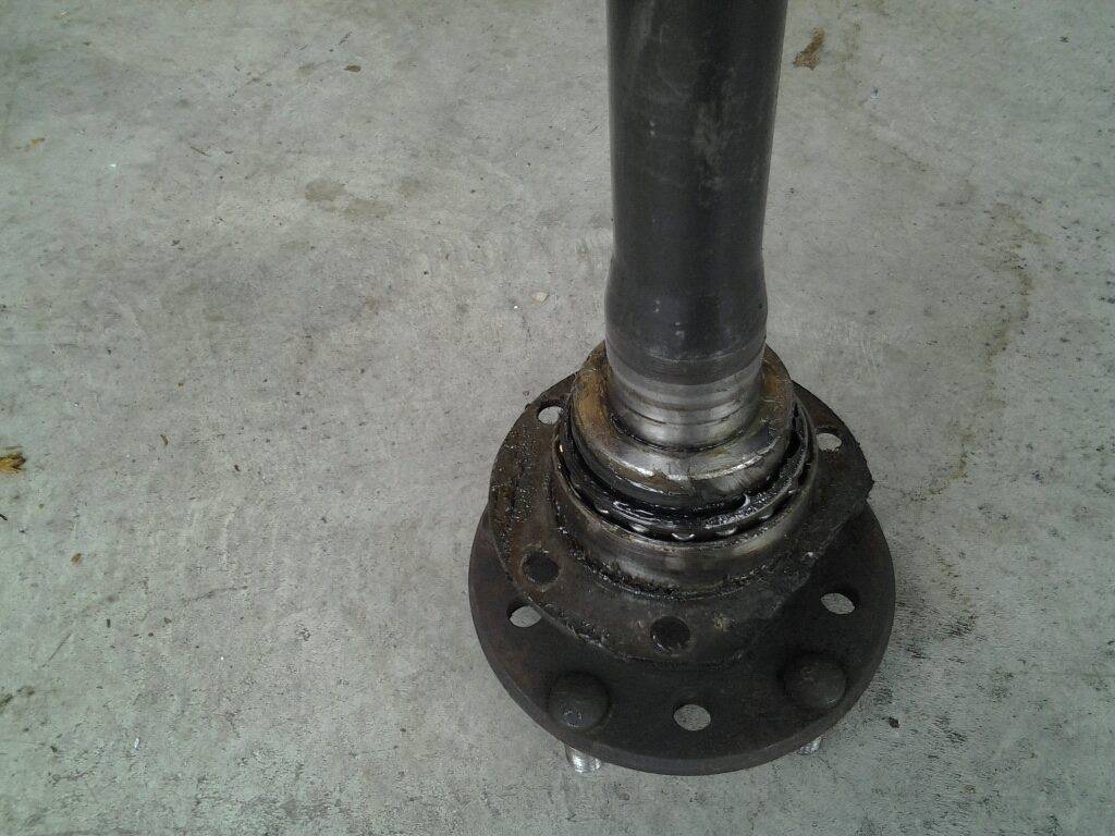

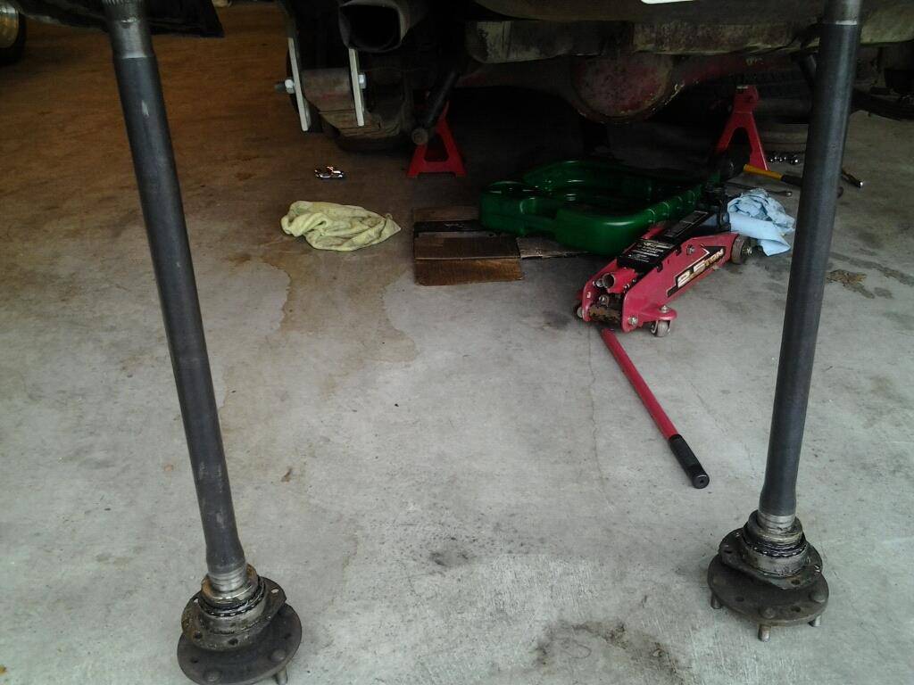

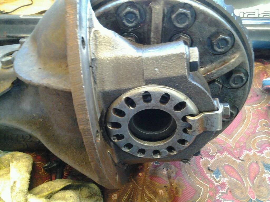

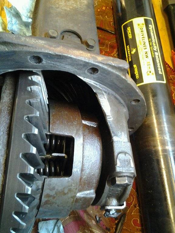

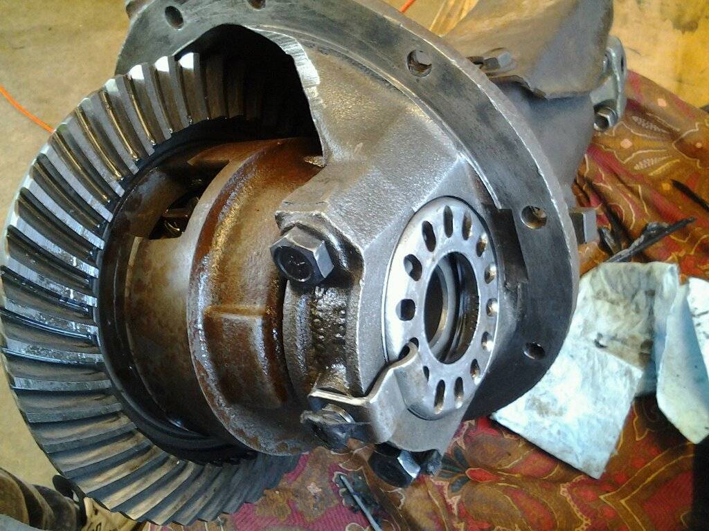

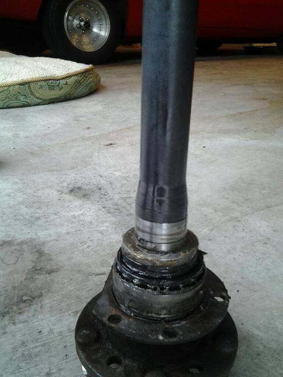

So i took the Duster 8 3/4 out, it looks like its in pretty good shape, no play in anything. Its a 2:76 Sure Grip.
Before is swap it to the Bee, i was thinking if it would really be worth swapping it if the Bee has a 2:93, or 3:23. Sure i would loaf along on the freeway, but wouldnt it be gutless of the line? The car is not raced.
Maybe you racers can help figure out the ratio, i may just do the seals and bearing depending on what you guys think. The tires on the car are 28x10x15's
I marked the tire at the bead, and marked the drive shaft yoke, and rolled the car on the ground. the tire went around once, and the drive shaft went around 4 times. Anyone know what that would make the rear end?
that is one tall gear ratio.you will get great millage on the freeway,but will be a dog around town.i dont think you will be happy with that combo in that heavy of a car.
Probably 3.91 or 4:10 in the Bee. That would be quite a change. Really noticeable if you go to 2.76.
if both tires rotated at even intervals and your driveshaft rotated around 4 times.. you are looking at a 3.91 or 4.10 gear ratio. agree with 64 belvedere... to identify the rear axle ratio in a non-SG unit and the car jacked up.. you ahve to rotate the tires twice and count the overall rotations of the driveshaft.. just an fyi.
That is the first 2.76 sure grip I have ever seen. Usually they are open gears.
