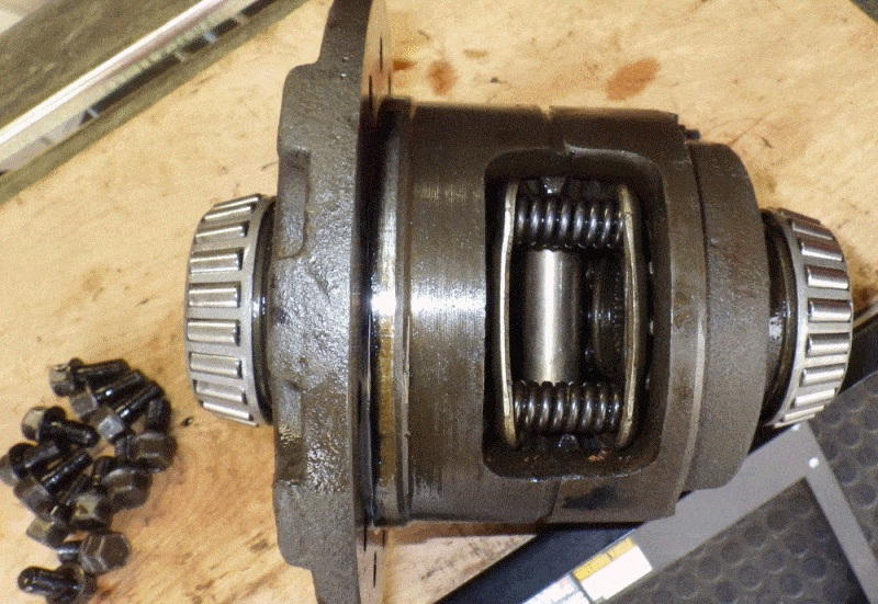

I don't know where you are in Ontario but I have a complete 8.75 for sale on kijiji. Complete, almost everything new, ready to assemble and run.
Its a 73 but ISO delete, 3.55 gear in a 489 case with clutch type suregrip new clutches. New tapered wheel bearings, almost new 10" drums. Swaybar with all new bushings. (bearings, seals, gaskets, clutches and SG additive are from Dr. Diff). This was for a 74 charger which has been sold.
I am in Ottawa, sorry wont separate and I'd rather not ship due to size and weight.
