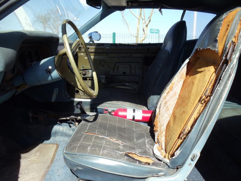

MY '72 SSP passenger bucket seat is not all torn up like the driver's side. Has anyone tried swapping them by changing the seat tracks and bucket backs where the release button is?
You could try it but, by the looks of your driver's seat, if you mess with those seats too much they are just going to deteriorate into a big pile of dirty scrap material. Even if you get that passenger cover on the driver side by swapping this or switching that, the "good" passenger cover isn't going to last long and before you know it, you'll be sitting on a seat much like you have now. If you drive the car much, I'd give that passenger seat a month MAYBE... Probably wouldn't even last that long.
You're going to have to get some covers and some foam. If you aren't at that stage yet in your restoration, then just get some cheap Autozone seat covers and stick some foam or an old pillow on that seat bottom to keep your butt off the springs.
