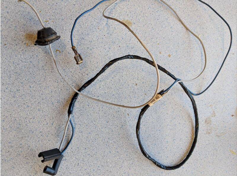

Here is the harness.
https://www.classicindustries.com/p...s8Zg01GCOFPx4du13W1pNFJ6T4W5yOSxoC5IIQAvD_BwE

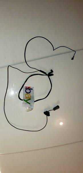

Here is a picture off ebay of an original tach harness under dash and under hood sides this is a 1968 Not sure if they changed for 69. Here is a link to it.
https://www.ebay.com/itm/1541224706...bPvG0V5y1zDfV-rooJ2nyYWv1LYXL-WBoCk0oQAvD_BwE

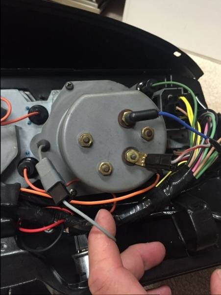

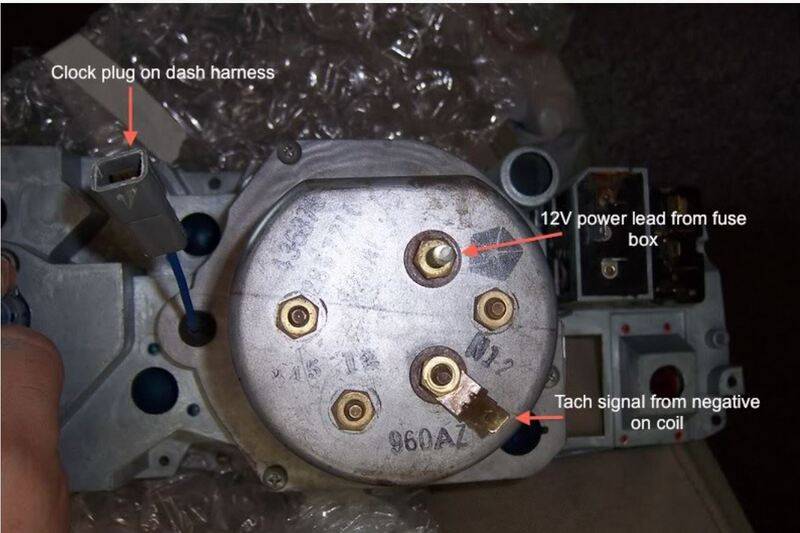

tach needs a positive keyed source and the trigger coming from - lead of coil. Aside this, the built in clock gets a constant + source, so your tic-toc-Tach should get 3 wires.
Gray for the clock ( spliced from the pink wire at light switch ), which should be part of the main harness, since on 68/69 clock was standard
On the harness posted by BeepBeepRR
Blue for the keyed source running to fuse box
Gray with trace for the coil trigger running to firewall grommet
