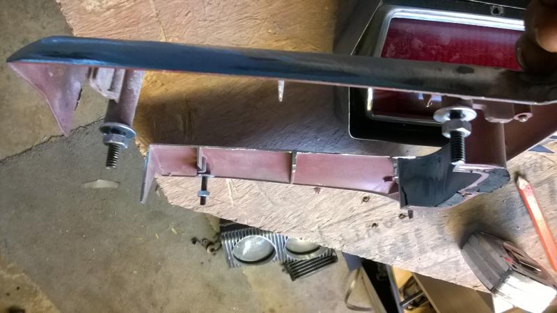

Does anyone know where i can get the nuts that attach the rear tail light extensions to the quarter panel on a 69 Roadrunner? I need 8 nuts but can't seem to find any. Any help is appreciated!
I sliced all of mine off flush and drilled and tapped them for regular bolts. Worked great, now I have positive fastening with washers and steel nuts on steel bolts. Mine is a 67 Coronet, is yours the same? Potmetal/whitemetal?
Thanks guys, i do appreciate it. Mine are indeed pot metal so i may go the drill/tap method as Ghostrider 67 outlined.
I have good used correct originals PM if interested
WP_20151122_15_20_32_Pro.jpgMine just did not hold tight enough for me. Plus 3 were broken so I had no choice, but, I would do it anyway next time. There's no substitute for positive tightening. And it only took a few minutes.
