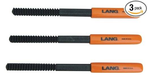

I have these that would serve you well.
Click to open expanded view
Lang Tools
Lang Tools 2573 3-Piece Thread Restorer File Set
39 customer reviews
List Price: $32.64
Price: $21.75 Free Shipping for Prime Members
You Save: $10.89 (33%)
In Stock.
Want it Sunday, Nov. 12? Order within 7 hrs 46 mins and choose One-Day Shipping at checkout. Details
Ships from and sold by Amazon.com. Gift-wrap available.
  • Pitches include: SAE rethread files: 9,10,11,12,13,14,16,18,20,24,27,28 and 30; Metric Rethread file (Millimeters per thread): 0.75, 1.00, 1.25, 1.50, 1.75, 2.00, 2.50, and 3.00
  • Metric rethread file in mm: 0.75, 1.00, 1.25, 1.50, 1.75, 2.00, 2.50, 3.00
  • Made in the USA
See more product details
New (11) from $21.75
Report incorrect product information.

I'll 3rd the thread files. They have saved my *** on more than one occasion.
