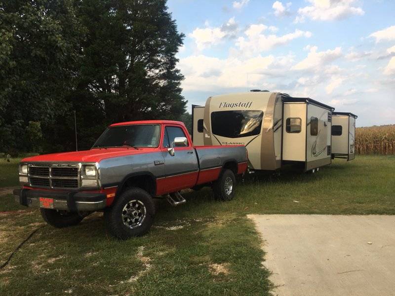

Here's my new camper.
Just traded for this camper Friday. Had the Goat for a few years.
