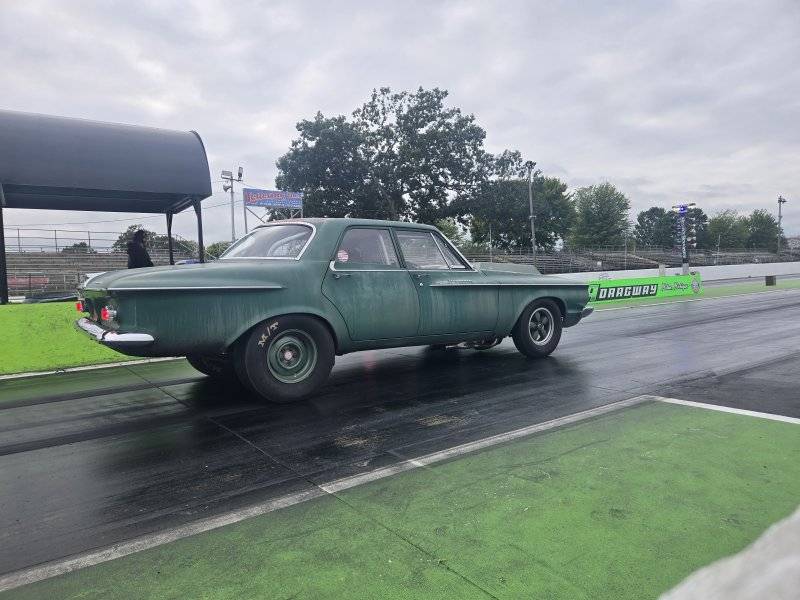

Tested my sons 62 Savoy tonight with the tire spin fix.

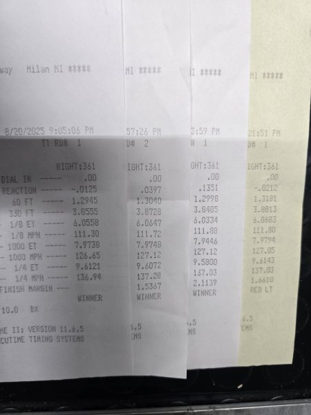

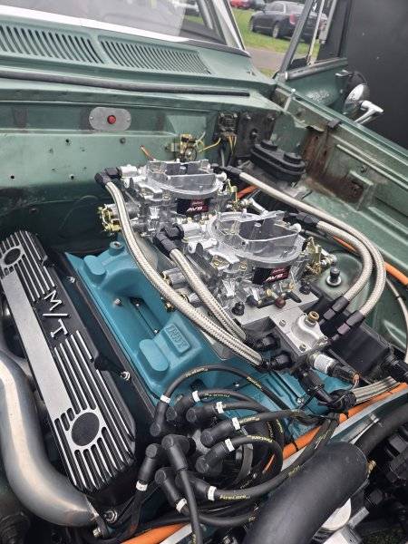

Tested at Milan tonaight after the spin problem the last few races. Mark Mennscer told us to lower the pressure in the M/T radial slicks to 16 Psi. Started at 16.5 psi. What a difference, 1.32 right off the bat. Then swapeed to the new Eddy Thunder series carbs, untouched and no air pan to seal the carbs. Imediately went 9.5800 (best ever pass with the 477") along with a 1.2998 60ft. We tried to run the air pan but it slowed down. Tried jetting richer with the air pan and it still isnt right. So more testing to get that figured out. Had a 12-16mph head winsd all night as well.
