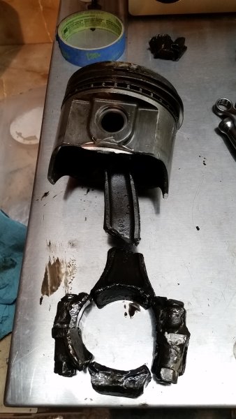

It looks like a connecting rod's hardware gave way, and it pushed out where the oil pan meets the block.

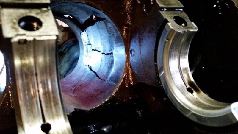

I am interested to see what happened on the inside. I guess the reason that I am so interested is because my 440 is stock original std bore factory pistons and rods. Please keep us posted.

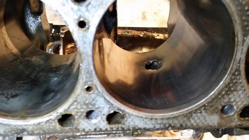

This is the only pic I can get for now. Block definitely has a window in it. My best guess is the hardware on a rod end broke? but I'm really not certain. It looks like a rod became detached from the crankshaft.
