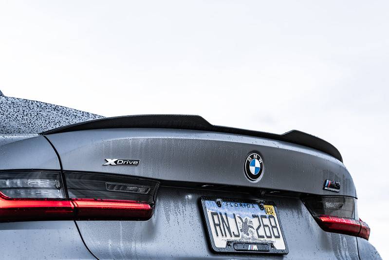

It seems everywhere you look these days, cars are sporting these notched spoilers:
It's annoying to me because the functional reason for a spoiler is downforce, yet you reduce any benefit of it by notching out a chunk. Form before function, I guess. Maybe I'm the only one that hates the proliferation of this goofy trend.... :lol:

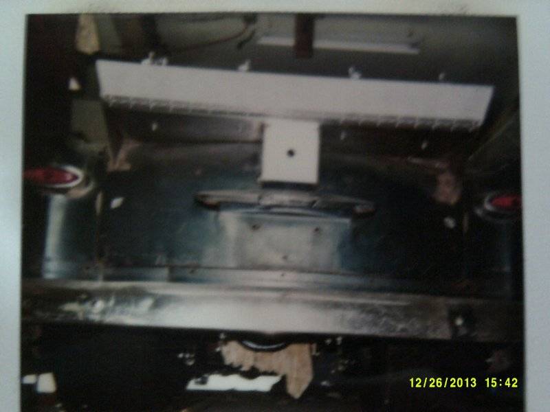

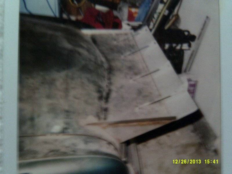

depends on how fast you're going, a wickerbill add down force
it was like 1/2" to 3/4" on a Pro-Stock wing addition,
that lil' wikerbill, added like another 150# to 200#s respectively of downforce
albeit it was at over 180mph+ @ 7.0s at the time, it made a world of difference
my 7.88 @ 188 Pro-Gas (NHRA 8.50 car) car's wickerbill, was like 5"s,
it worked very well, adjustable for the angle
the higher in elevation the higher the angle was, thinner air less down force
this was still in the building process
