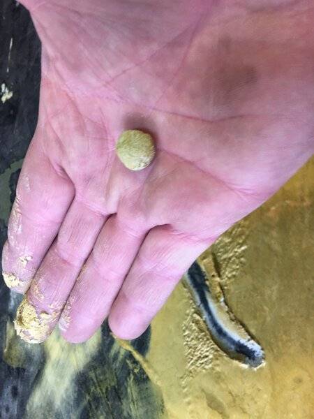

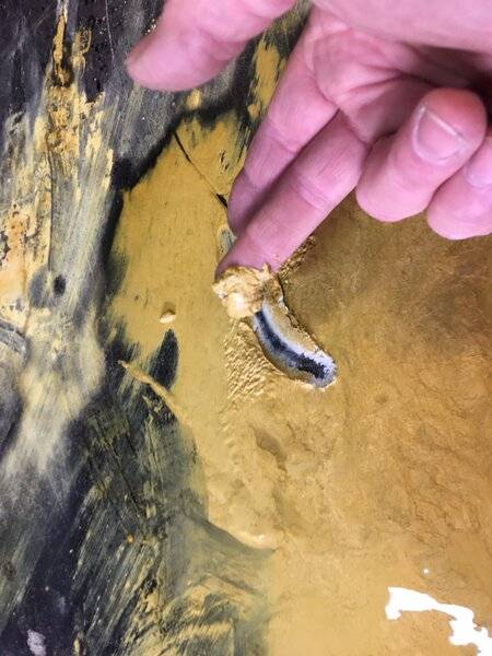

I did two rounds of Thermocure last year. On the second drain/rinse a nasty clay like goo came out of the block plugs that must have been old head gasket seal or similar crap. Like Demonic said you'll have to rinse a lot, or you'll smell it in the coolant for a while. Clean and clear now.
