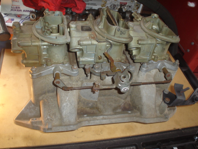

you can get the whole kit-and-kaboodle from one of the Mopar vendors.
I think it's a great idea. I bought mine on fleaBay, not on the car yet...
I guess is it for the look and cool factor, or more the performance gain? I think they are very cool, and have toyed with the idea before myself, but for getting down the track, I still have found a good old 4 baarrel holley works best for me.
Mike
I agree that it's more for the "cool" factor than horsepower and it's a pricey project. I was looking for answers to whether I'm forgetting anything in the parts department, and do I need to change the harmonic balancer. Also is it all going to fit with the air grabber? GrabberOrange's looks pretty tall.
well think about this ... the factory installed them in cars with AG and used the same air cleaner ... one with bug/rain deflector and one w/o. one w/o deflector is for the AG. the ones in the kits i've seen have deflector but you can remove it easy enough for AG use
the cleaner base is swept down like an upside down bowl to keep profile or height of the set up down
