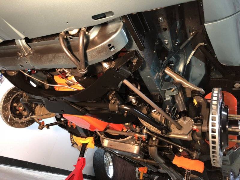

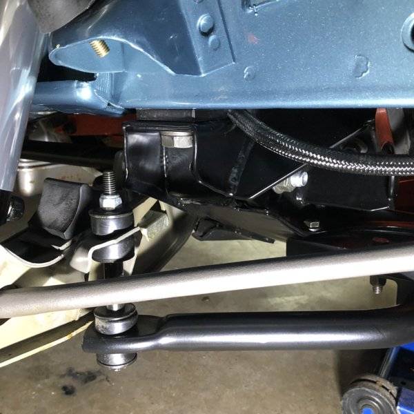

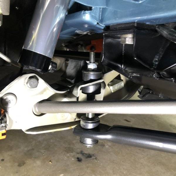

I've got about 3/8" to 1/2" metal plate between the K and the frame just to gain hood clearance. 71 Hemi Charger SE (one of none) with flat hood
