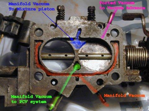

I can't seem to find any good info on how and where to hook up the vacuum lines coming off of a Carter BBD on a 318 1974 Charger. All of mine were eaten and completely detached when I bought the car. I checked out a later model Factory service manual and have the 1974 FSM on the way. Does anyone have any pics they could post showing what hooks into what?

Hi Drifter, I have a couple BBD manuals that shows what each port is for if that helps although it is a 7meg pdf format document. If you would like me to send it to you just PM your email addy and I'll be happy to send it to you. I also have the pic below which may help but its a BBD for a Slant super 6 I beleive.
