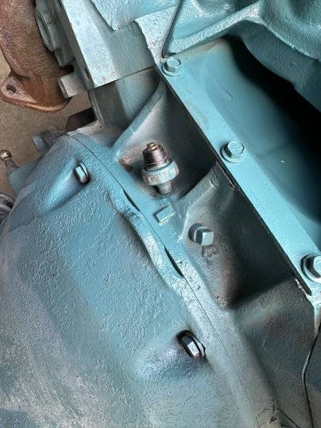

This is on 1969 Super Bee, 383, 330 hp version. Looks like the ones online for the idiot lights and not the gauge. I have the gauge of course, electric not plumbed in.
Since I purchased the car, Tthe engine was only running for a short period of time moving it around and I really don’t recall if the gauge worked then. I’ve since had the entire cluster restored.
So many things were backyard engineered and I don’t want to get it back together then have to replace. Easy switch out now.
Thanks

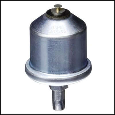

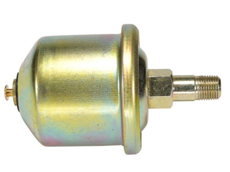

That one is a straight-up switch...it does only 'on' or 'off'; it runs a warning light only. If you have a gauge (with a needle and pressure graduations), you need the larger variable-resistance sender.
I think these are the part number?
2495222
3486609
2495222
3486609
Mine has a gauge. Thx
