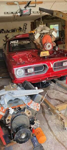

The engine I'm putting In now is from my old GTX.
We'll see what it does in a car that is 500 lbs. Lighter and has a chassis...

Spun rod bearing

They were brand new eagle rods, cleavite bearings, all coated. New crank and billet steel caps. Block half filled.
No cap walk visible.
Till now I have only removed main caps. Those bearings are fine...
