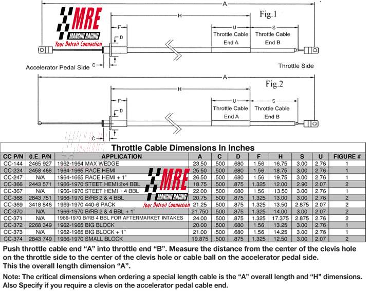

Got a 440 In My Plymouth Satellite, Not Sure What The Motor Came Out Of. Truck Or RV Maybe..
Just Wondering How I Go About Measuring For A Throttle Cable?
Prefer Stock Looking But Im Open..
Any Good Places To Buy From?
Running a Edelbrock Carb. Thanks
Here,s a chart from Mancini
