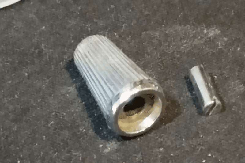

how do you take off knob,is it reverse thread? Cant get it off thanks
There is a very small slotted screw in the face of the knob.
I seen that but wasnt sure. So just unscrew it and it slides off?
Yup. A good set of eyeglass screwdrivers are your friend here.
Hold the larger thumb wheel while carefully undoing the screw. Don't lose the screw....they are hard to find.
The nut can be stubborn. If the small tool you are trying doesn't give you the torque, I have taken one of those shirt pocket screwdrivers and ground down the sides just enough to get inside the knob. It gives you more to hold onto. Of course the regular clock uses the same knob and fastener.
@davek - I found this photo for you of when I last pulled mine off.
