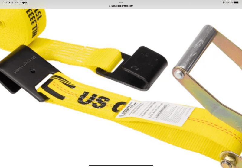

I use two flat hook ratchet straps hooked to the lip of the K-frame. I had to shorten end of the hook so that it hooks flat on the edge of the K-frame.
