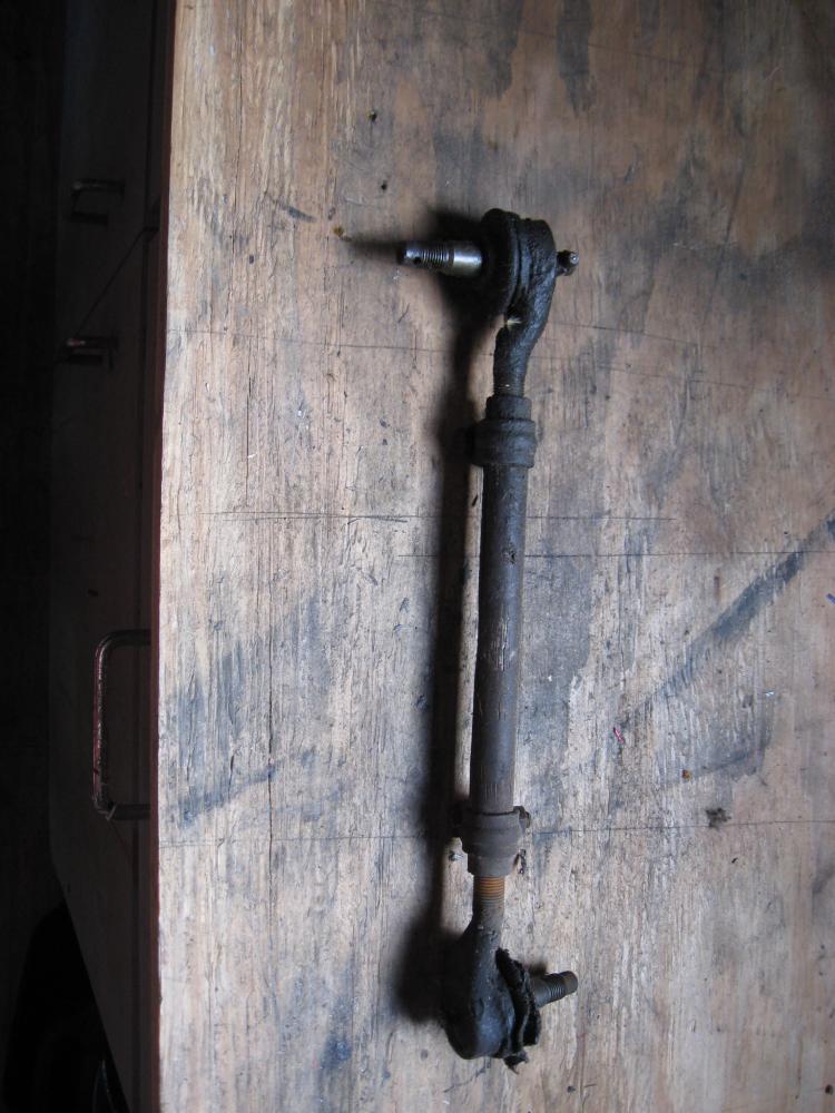

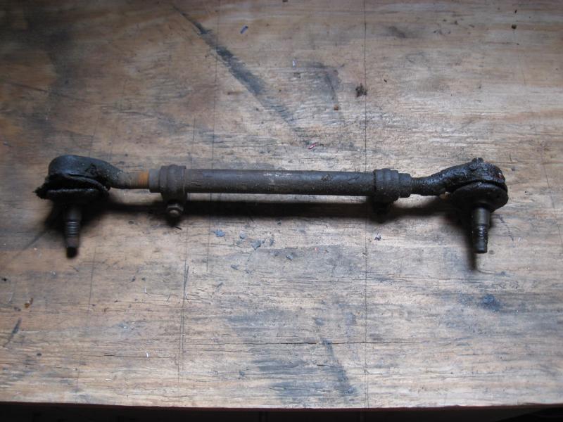

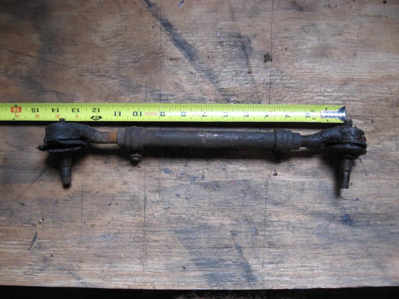

Whats the best why to measure tie rods without doing an alignment? I bought new tie rods and sleeves. I wanna match them to the old ones
remove the tie rod assembly as a unit...(pic 1 )
turn one of the tie rod ends 1/2 half turn so they both point the same way( pic 2 )
measure from dead *** center of grease fitting to grease fitting ( pic 3 )
duplicate on new assembly and turn 1/2 turn so one points one way and the other points opposite.
put on car and do the other side!..........TA-DAAAAAAAAAAAAAAA
THEN GO GET A FRONT END ALIGNMENT!:headbang:

Park your car on level ground then using a tape measure, measure from the center of the tires and note the measurement. I like to use a scribe and circle it with white chalk so it's easy to see. Then go behind the tire and do the same. The front marks should measure just a tiny bit less than the rear (helps to have someone helping plus I use a pair of ramps to do this on). Pull off the old tie rods and made the new ones as close as possible to the old ones like mentioned above. Put them on and recheck your measurements and adjust as necessary. Drive it then check again. Doing it this way isn't as accurate as an alignment rack but it's damn close. I've been doing my own alignments for years and my tire wear is always good....
