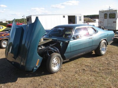

This is my 71 Demon drag car with a tilt front end. I bought the car with the tilt front end.
It is a lot easier to work on, and it cools down pretty quick at the track in between rounds. But not everyone likes this look. I myself am on the fence about it, but it does work well.
Mine is all steel and it rotates on the bumper bolts, really easy, I can put it up myself. I just wished they wouldn't have cut the fenders the way they did.

hi and thanks for all the input,still in the planning stage.your demon looks great,that is what im trying to do,mark
