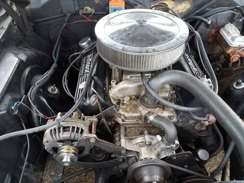

The car has issues one heel toe downshifts. That is usually when it pops the belt. It has had a failure on both the PS one and the Alternator.
Here was it in the rain back in Apirl

Picture from 2018. With a missing belt of course.
What are we missing?

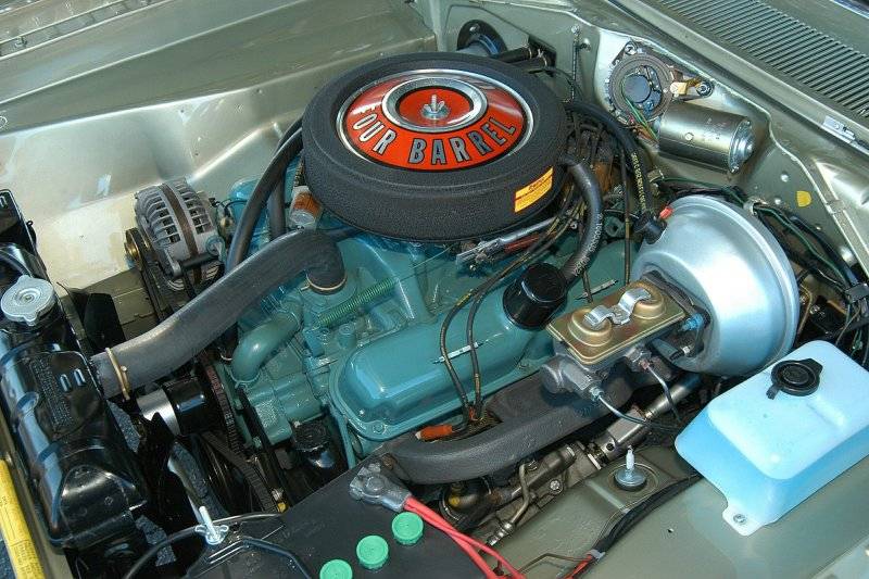

Everything. There is not one thing right with any of it. You need all the correct brackets and pulleys for a non-a/c car. Right now you have a hacked mess. I would not drive it around the block let alone try racing it. Here is a pic i stole off the net.

I agree. You said you got a "replacement" set but of what? That alternator bracket you have is not doing you any favors. It has no lower support so it's probably flexing on the shifts causing momentary misalignment. Get all the correct V-belt accessory brackets (plus the right hardware/spacers) then see if you're still pitching belts.

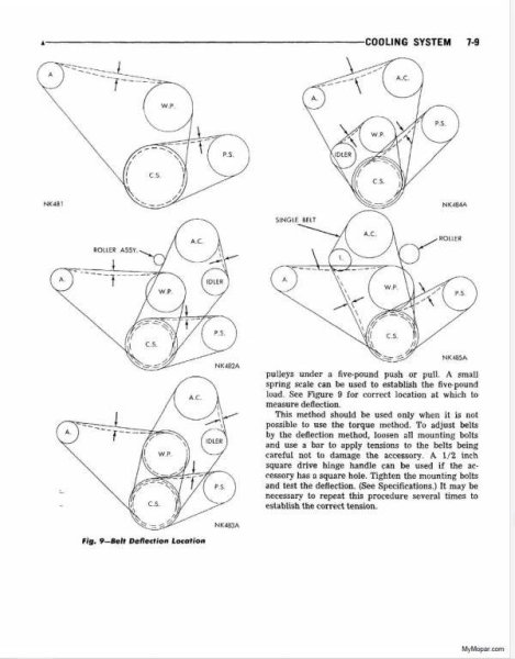

Also, the fan belt should not be driving the power steering pump like it is in the picture so you need a two-groove crank pulley to start. P.S. belt is only between the crank and P.S. pulley. The "fan" belt goes around the water pump, crank pulley and alternator. Hard to understand what's even going on in that pic without seeing the crank pulley.
Also check your motor mounts to see if they are not shot and maybe look into a torque strap to limit the engine movement.
Top left should be you.. PS on front groove (on the crank) WP on the rear groove.. They do make different length water pump pulleys also.. in case yours doesn't line up with the rear.
Guys raced for decades with v-belts.. should be able to fix that up.
Just took another look at your pic... the alt should be bolted straight into the head, that rear bracket creates a flex point... This front bracket would get you in the right spot, that top alt bracket is more than likely your problem, only takes a bit of flex to send a belt into space.
OR.. you could make a small brace going from the back of alt to a valve cover or exhaust bolt so it cannot move (once you have it in place with the belt tight) That would be the free option...

Also.. mounting the alt to the head will drop it like 2-2.5" which means shorter belt and less chance of flinging it

One last thing (sorry for all the posts) Looking at your pic, the spacer in between the alt mount ears looks short, when you re-do it make sure you have all the spacers setup properly so you can tighten it up good without flexing/breaking anything.. take away any chance it has of flexing/moving :)
