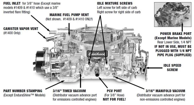

I'm assuming your referring to the vacuum advance on the distributor. I always used the timed port provided for it.
There is manifold vacuum and ported vacuum. Manifold vacuum is what you want to use for the distributor advance.
Looking at the Holley literature it seams it's just a matter of whether you want vacuum present at idle (manifold) or not (timed). I also believe some like manifold vacuum because it helps smooth out idle with bigger cams??
Shoot, I always thought that was as reversed, Hemi Reb!

Well, I guess I'll be trying the rear port on my torker 440 intake versus the metering block port on the 850cfm. Will have to check the advance can to see what it kicks in at. I didn't realize that they offered different vacuum levels for the advance can.
Timed dist advance is what 99% of Mopar came with from the factory. If you change to manifold vacuum, it will not run correctly unless you re-curve the mechanical advance inside the dist. If you are basically stock, use the ported vacuum
Quite right. Ported vacuum is something they did for emission control.

if you are running a stock system, use the ported...if engine is modified, you can use manifold, but other items will need to be changed as well....I tried manifold vacuum on my 66..it did not work....you are gonna have basically full vacuum anyway at cruise. Starting out from a dead stop, if you have manifold vacuum and give it gas, you will be retarding the timing, not what you want. With ported vacuum, you will be advancing the timing.
Again, most all Mopars from the era came with ported vacuum when made.
Stock motor timed port. Modified for off road only neither because it's only mechanical advance... in between it depends on the builder and the intended purpose
You hook in it up any way you want. You need vacuum advance at idle. You need the lead time to so that complete combustion occurs by 15degrees after tdc. And not just for modified engines. With manifold vacuum, when you give it throttle, it gives a shot from the accelerator pump, which fattens the mixture. The richer mixture burns faster and requires less lead time. You want rhe vacuum advance to back off.
