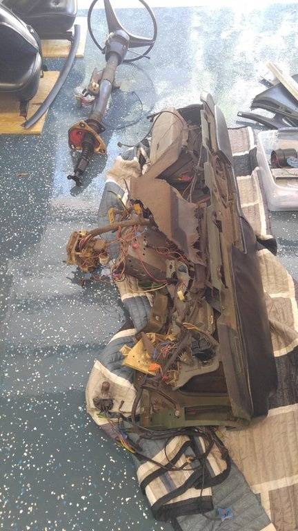

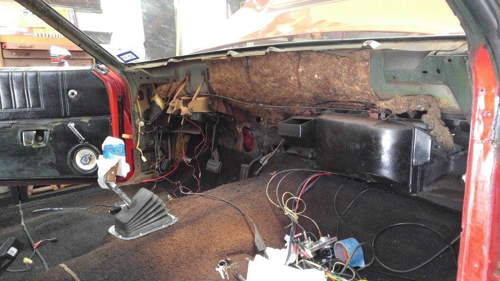

Just did this on my '73 road runner. I removed the seats and steering column. Made it easy to maneuver the dash frame out of the car.
I used Nacho's list, pasted it into Word to edit it. I then itemized it into bullet points, and checked them off as I took care of each item. Nacho's list is great!
Couple of areas to double-check, be sure the antenna wire is completely detached, and be sure the HVAC control cables are free from the braces that reinforce the pedal assembly.
I did a similar thing too redrunner. Got it out! Now to clean it up and get to the real work.
Isn't really HARD to do it, right?, just be patiente and double check on every harness or anykind of line being out of the way... Fortunatelly we don't have to remove the windshield like earliers!
Yeah it really wasnt too hard at all. Like you said, patience pays with this job. I can already see 10 other things i want to replace on this thing down the road. Guess ill tackle that stuff whenever i get AC this winter. Your check list worked great nacho. Thanks again. We wnt ahead and removed the seats and steering column since it was easy enough to di. Made it way more easy and comfortable to work on.

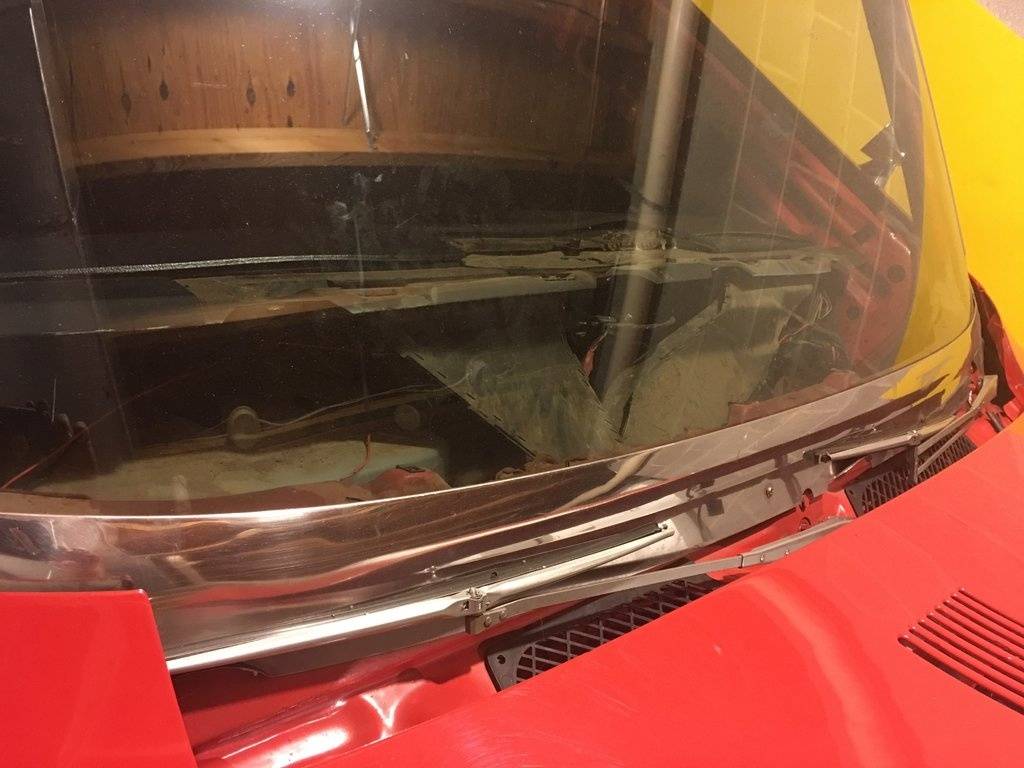

Has anyone replaced this insulation or know where to get it from? I dont see it listed anywhere and would love to update it.
I simply will use anything available locally. Maybe that suff used for air conditioning ducts insulation ( not the yellow fiberglass ) or dynamat. I can't spend money bringing stuff from USA anymore.
Upholstery shops use to have a similar material made with gray cotton.
