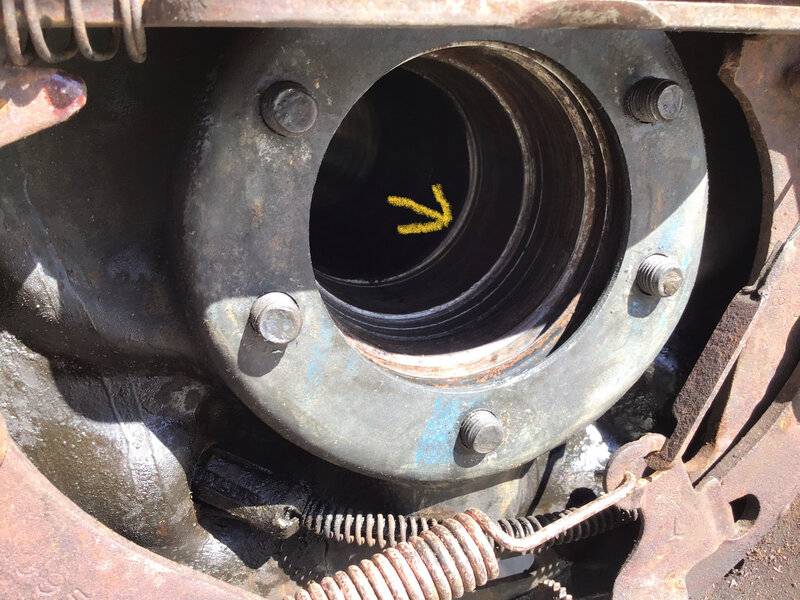

The yellow arrow pointing to the step where the seal stops. You will feel it stop. Good idea above to measure how deep the seal is in from the end.

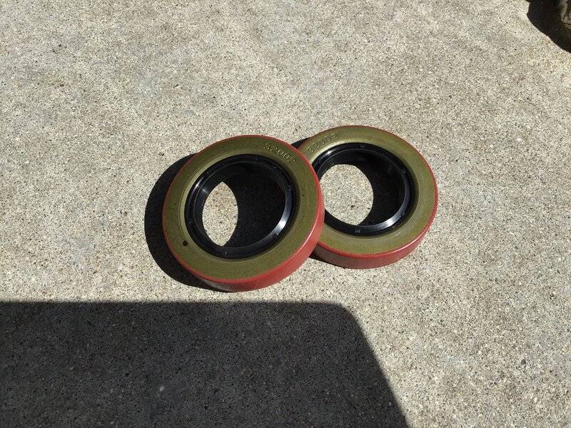

get something that is close to the same OD as the seal to pound on so you don’t bend the seal. Put some grease on the inside at the spring to keep it from popping off the seal when punding on it.
