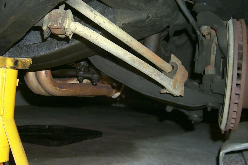

Headers: All headers I have seen for these cars have the driver's side that hangs down very low, under the steering gear. See attached picture of my son's daily driver 73 Roadrunner with a 340.
(318, 340 and 360 all fit the same) Many years ago I ended up welding a piece of angle iron to the bottom of the k-member to keep the headers from getting crushed. I all but guarantee you that if you just put the header's on and make no other modifications to the suspension, that you will ultimately crush the header pipes darn near flat.
There may be other header designs out there.
As far as installation, I had no clearance problems and even the stock starter fits. Of course, you need to take the steering apart a bit to route it through the header, but that is not too bad.

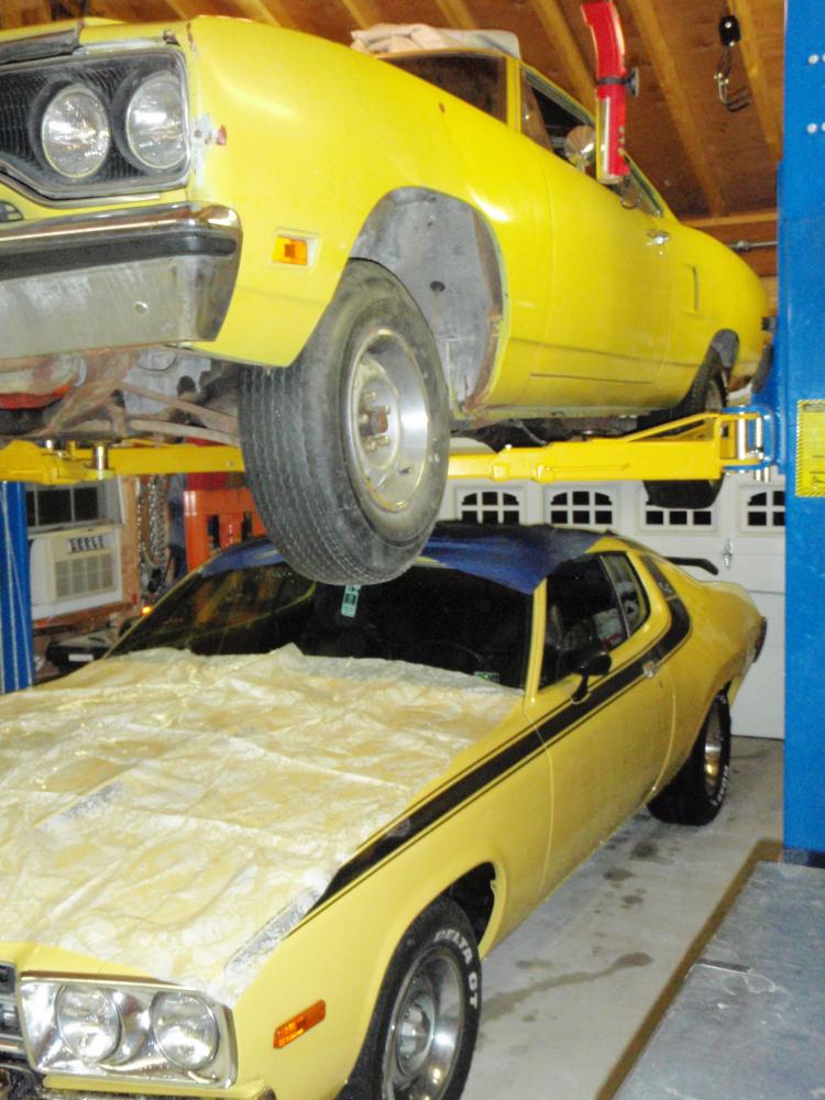

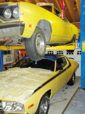

Tires. I like 275/60R15 tires. They fit very nice, have absolutely NO fitment or rubbing issues. This assumes that the 15x8 rims have a 4 1/2 inch backspacing. Some have fit larger tires, but I think the 275's work great. See a couple of attached photos. Not the greatest for showing the tires, but hopefully they help...

hsorman, thanks alot for the info and the pics, that is a huge help. I think i may just go with that tire size, it looks great on the '73 RR. You have a sweet collection of cars, and i hope your son knows how lucky he is that you gave him your first car, an awesome car at that. Thanks again for everything.
