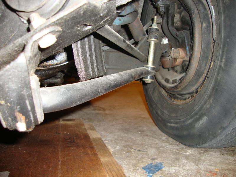

Does your car already have front sway bar? If so, are the bottom of the LCA's boxed with the weld-on plate? If not, you should buy a set from Mancini and do that. The large front sway bar will deform those LCA's in a hurry if they're not boxed in.
i have a stock sway bar, (it measures out to 1.06 w da mic). i took a look, and it doesnt look like they're boxed in. ill take a pic and post it. i dont really think i need bigger than that do I? IDK

dont think they're boxed...
