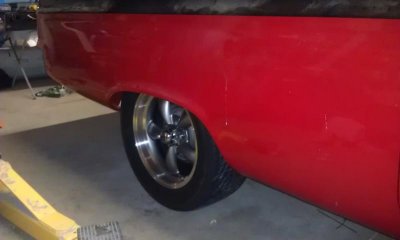

criterion rv8 038.JPGcriterion rv8 023.JPGI have I believe 275/50/15 with 10" steel rims on a 65 satillite but, I don't remeber the backspace on them I had them custom made.criterion rv8 033.JPG

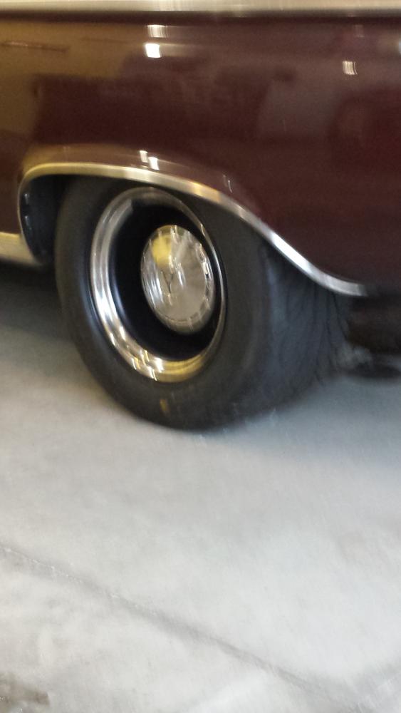

I have a stock 1965 Coronet with 12" ( 305 mm ) wide Mickey Thompson Sportsman SR on my rear with 10" x 15" x 4.5" backspace wheels. I had to install new springs to keep the rake of the rear of the car up ( not a lot though ) they fit and look great.

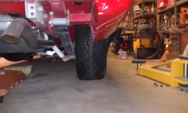

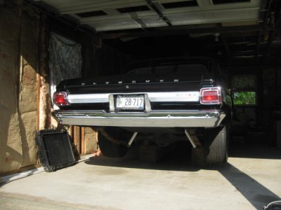

IMAG0410.jpgIMAG0408.jpgI went with 275/50/17 tires on 17x8 rims with a +12mm offset (5"). Tire gets pulled within 5/8" of the leaf spring.

Rear Wheels
Have a picture form the side and back of this setup you can post?

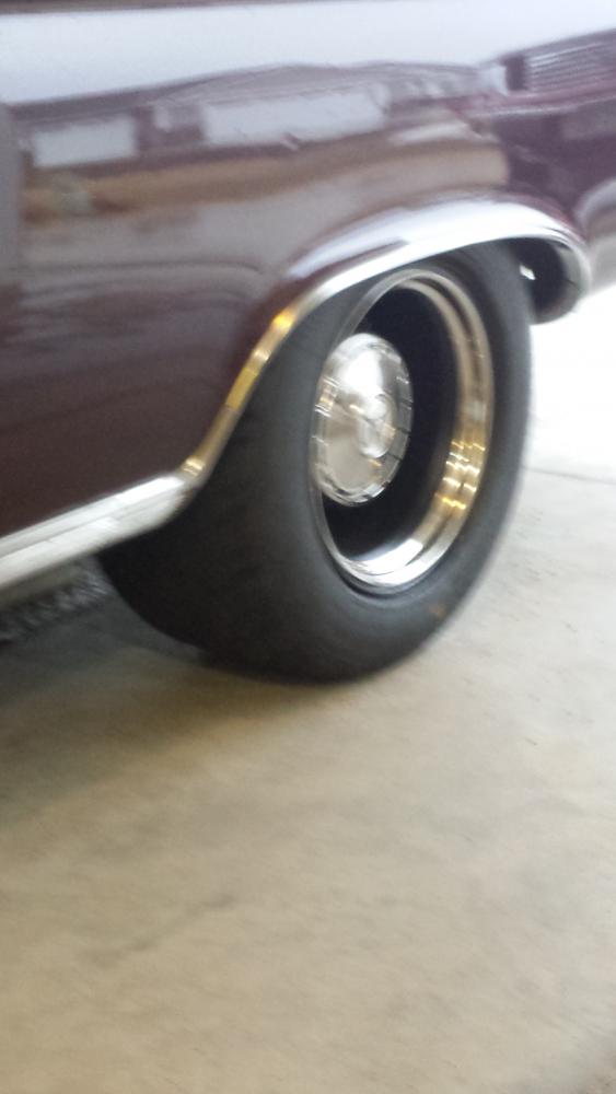

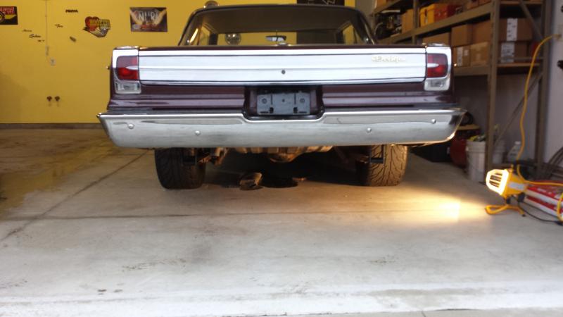

Pictures and new plan.
I have posted some semi clear pictures (my new smart phone sucks) of my set up as it is now. I have the shackles on yet that I used to get my baseline of how much arc to put in the new springs. They fit and I have had people ride in the back with no noticeable bottoming out or tire rub. My new problem is I bought 26" tall tires that matched the factory height so I wouldn't have to change the speedometer gear. I do not like the look of the 26" tall tires and if I go with 28" or 29" with my current set up I will have tire rub issues unless I jack up the back more which I don't want to do. My plan is to mini tub & narrow mine and solve the problem once and for all. If that option isn't for you then I would recommend maybe going with 295 mm or 275 mm as you should be able to go taller if needed with no issues.
