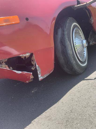

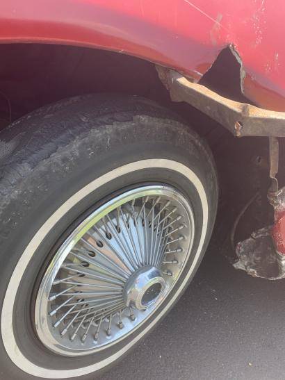

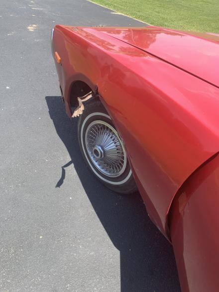

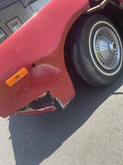

Hi. Today I was taking my old 74 out for a cruise on the highway, speed limit for this section had me going about 55-60 mph. Suddenly a series of loud knocks and bangs followed by some sort of smoke pouring up from the floorboard, just in general very scary. I assumed I had just ruined my engine and so I coasted to a stop on the side of the road and shut it off immediately. Got out to check things over, and sure enough the engine seems to be okay... but the drivers side fender and fender strut is absolutely mangled and my tire is stripped clean of its tread. I had planned on getting new wheels and tires soon anyway so that isn’t too big a deal, but on the other hand my fender is so damaged I can’t even hardly believe it. Im guessing the smoke was just dust from the tire shaving its tread off?
So... I would like to find a good shop or place around the Western Kentucky area that either knows their classic car bodywork or mopars in general who might be able to set me up with getting my fender all repaired up. I’ll include some pictures I took of it too, it’s nasty :(

Ouch...how old was that tyre?....looks pretty old and dry.
From what I could gather based on the last registration of the car by the owner before me, they are at least back to 1993. I've been using them for a while now, they seemed to ride and stop fine but I guess my luck just ran out on the driver's side front rubber. Surprised the rears haven't gone out...
Sorry for your loss but man you always have the check the tire dates on these old rides. Having tires from 1993 is way dangerous.
There is always a date code (usually stamped in an oval on the sidewall). No tyre manufacturers recommend using tyres over ten...and some only recommend using tyres older than 5 if you do a thorough annual inspection for cracks and bulges. At least no-one was hurt.

Might be cheaper to find a fender.
last time I asked about fixing one I was quoted $1500.
I found a perfect one for $300.
Still needs paint but it won't be $1200 to paint it.
Sorry to see that. Yep, you need a fender and braces and figure on blending onto the door to get a decent match.
you would be way ahead of the game finding another decent fender.
