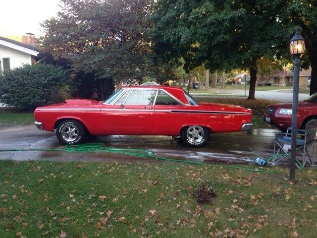

So I found a '65 Coronet 440 that was what looked like a turn key operation - but we all know how those go. It's getting some electrical work done to it now - fixing the stop and tail lights, interior lights and replacing the old 3 gauge panel under the dash with 3 separate gauges mounted in black cups on top of the dash. Have a tach w/ a shift light to add to the dash - to make it that much faster - lol.
I purchased a new set of Cragar GTs for it - 15x8s for the rear - 4.5 backspace and mounted a set of Cooper Cobra 275/60R15 and 15X7s with same tires in a 215/70R15 up front to replace the steelies and the dog dishes. Funny after all of the MOPARs and other cars I've owned, this is the first new set of mags and tires I've ever bought to put on a car. Most of them already had some sort of wheels on it and I kept them.
Hopefully, the '65 will be finished by week's end and be able to cruise around town Friday night in the Route 66 Mother Road Festival coming up this weekend. If not, we'll take up our usual haunt in the lawn chairs along the route and watch the vehicles go by. Last year there was a '67 Hemi Coronet R/T that rolled by us - it was nice!
Do you have pictures of your Coronet with the Cragar GTs on it? I just got two 15x8s and two 15X7s Cragars SS, and I am looking to get 295 or 275/60R15 (rear) and 255 or 235/70R15 (front), for my 73 roadrunner. but I would like to see the stands front and side
This is all I have loaded on my computer currently - I'll take some more shots of it this weekend.
I've got 275/60R15's on the back with 215/70R15's on the front - those were close to the rear tire diameter and about as wide as I wanted to put on front with the manual steering.
