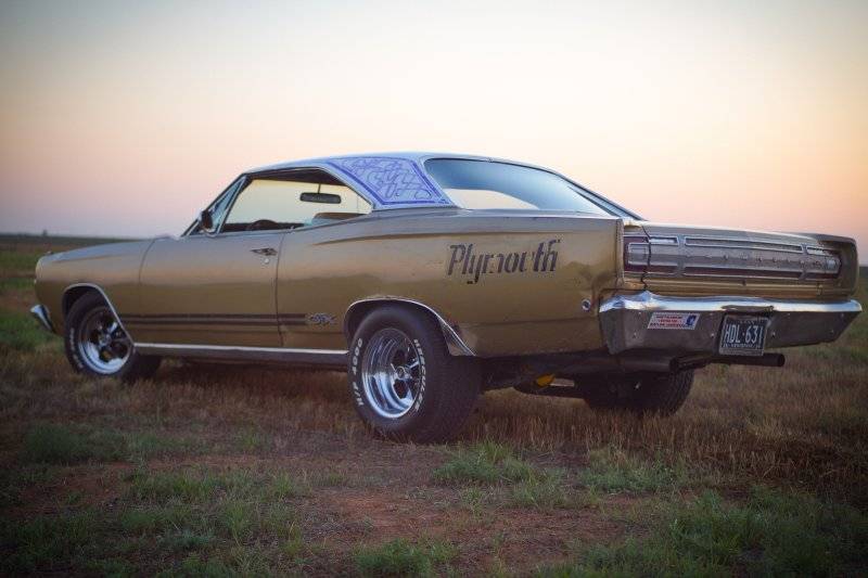

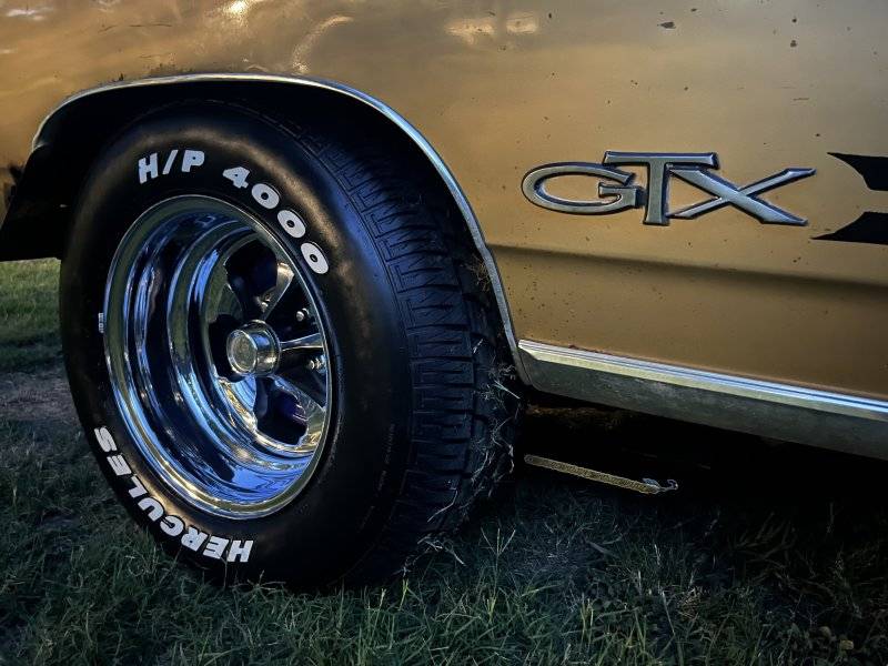

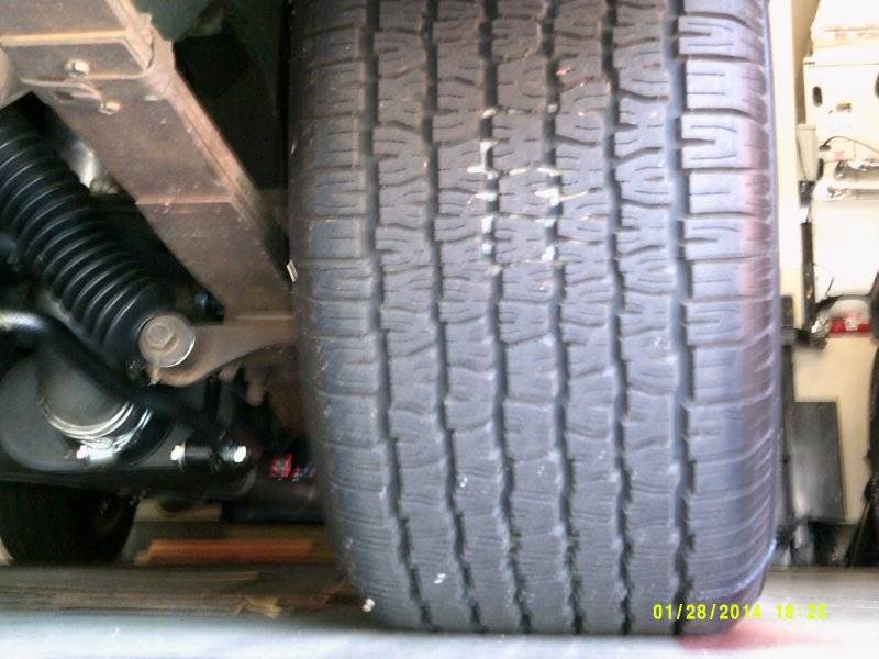

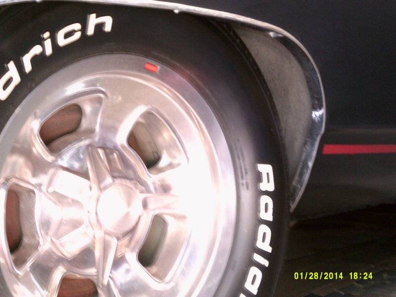

Im running a 15x10 with 5" backspace. 295/50/15. It's tight but no rubbing so far.
Theres enough variation car to car that makes it a hard question to answer.

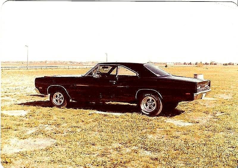

I've had 10.5x28 slicks on a 15x8 1/2 rim with 4 7/8 backspace, on a 69 rr. (lips rolled, however)
Equivalent size street tire is a 295/55x 15
The wider the rim is, (10") the more perfect the backspace needs to be.
Imo, more backspace is always better than not enough, given a choice. With a bit too much backspace, a spacer can make it perfect.

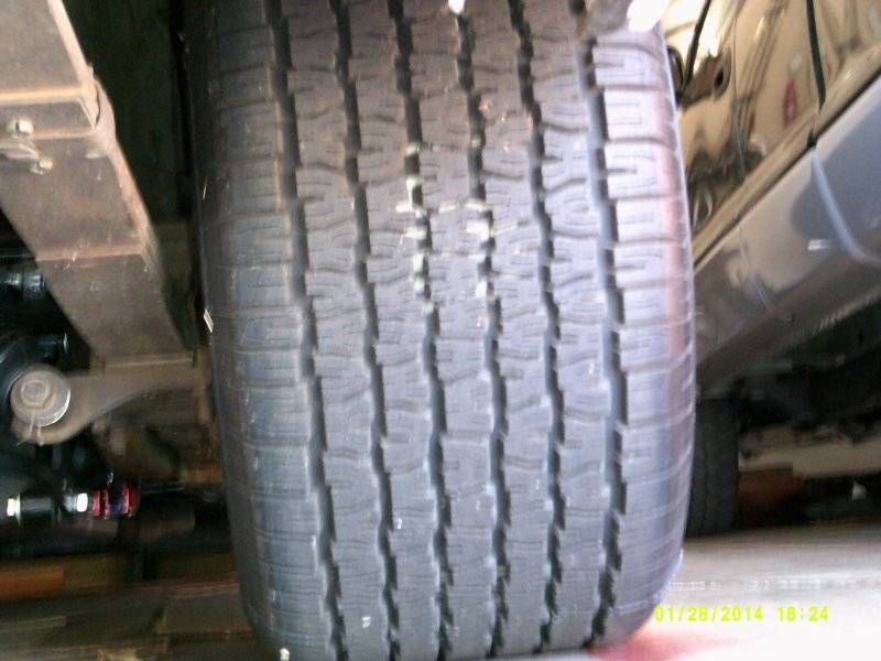

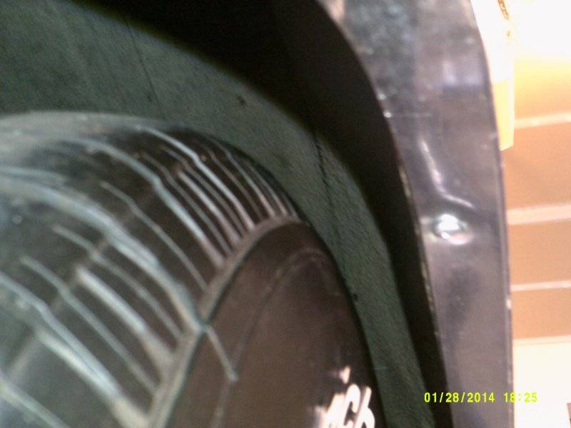

69 RR ... 28 x 12.5 x 15 Mickey Thompsons. These have only 3/4" clearance to the front lip of the quarter. The car is mini-tubbed. 10" wheel with 5-1/2" backspace AND the rear has been narrowed 1/2" per side.
Key points:
28" is as tall as you can go with stock axle location and stock wheel opening.
10" wheel/tire combo will be really tight in a stock tub.
That’s bullshit! That’s a Dodge - the OP has a Plymouth. Totally different wheel openings!
