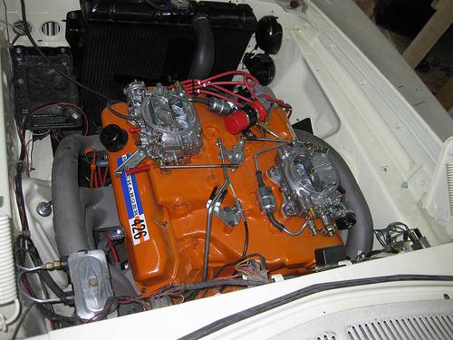

Well a friend and I took the Max Wedge for a ride today. Definitely almost not for the street. With no shroud and a four blade fixed fan it is not conducive to stopping in traffic. It does not like to idle very long, but when the pedal goes down, WOW! I think I will stick to driving the other cars and leave this one for the trailer or a show not more than a few miles away.

Great looking car. More pics please!
Is that a heat shield under the master cyl?If not you will need one,mine got so hot you could fry a egg on it.Lots a underhood heat with the MW manifolds.
Not in that photo but we fabbed one up yesterday just for that purpose...we'll see how it works
Ya gotta love it ! Ron
