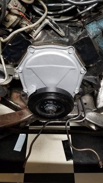

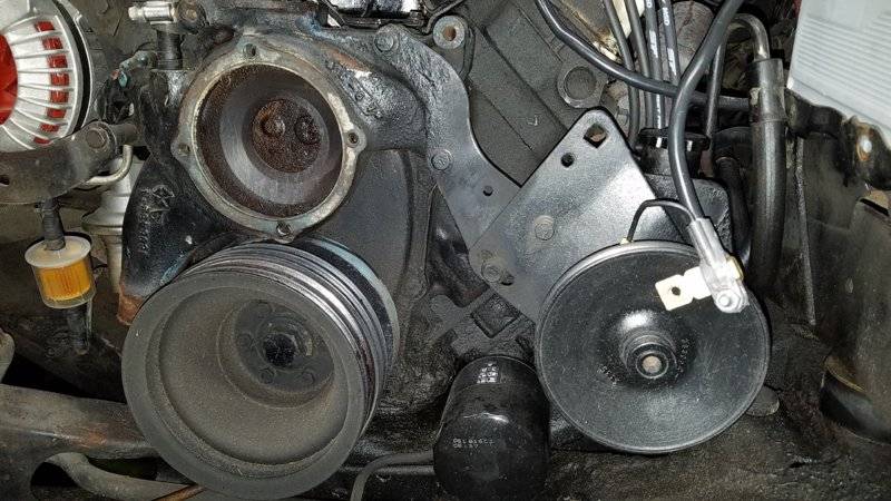

I have pressed on the harmonic balancer on my 400 after replacing the timing chain and gears. I have a deep pulley. Any suggestions on the easiest way to keep engine from turning over while trying to torque it down to 135 ft lbs?

So disregard my comments about the pulley. After checking, the center bolt and washer are smaller than the center hole on the pulley:rofl:. Can you tell it has been a while since I took it apart? Still trying to find a way to keep engine from turning over.
Maybe flex plate as suggested?

best to take that deep pulley off when torqueing your crank bolt as it gives a lot of potential side leverage
if you do torque with it on keep your extension absolutely straight
easy way to round off the hex on your crank bolt
