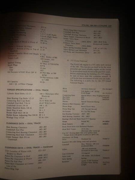

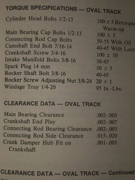

95 In.-lbs for the Windage Tray 1/4-20 bolts
From this book
This page:
Windage tray
Thanks! Exactly what I was looking for.
