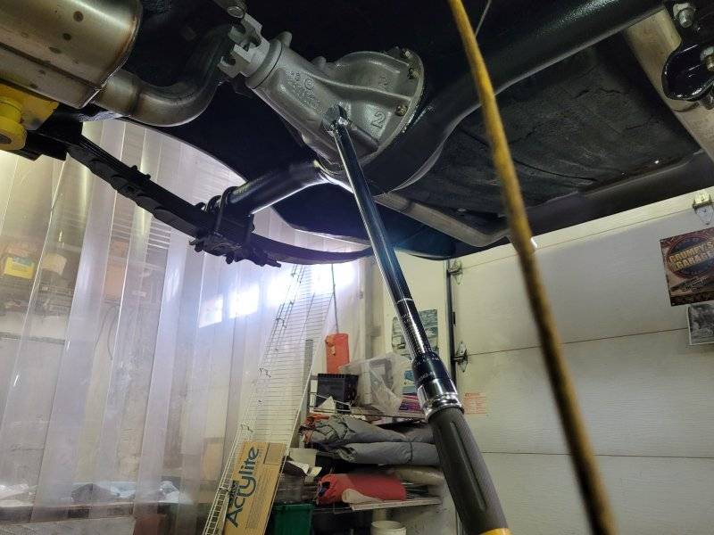

I've never snapped one and I've done a fair number of swaps. Had to zoom in, but yep wrench set at 45 ft-lbs...
I also treat my torque wrench with respect, seeing I bolt propellors on with it.
