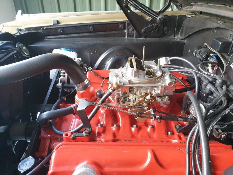

I have experienced that exact issue - for mine the fix was readjusting the kickdown to provide more pressure, but still allowing the carb to open fully. It was a very fine adjustment, took a few goes. I couldn't achieve both goals without putting a small bolt in the kickdown lever slot. I tried to eliminate it but it wouldn't work. On a factory set-up it isn't required but once you start changing manifolds, carbs etc it can be.
I have experienced that exact issue - for mine the fix was readjusting the kickdown to provide more pressure, but still allowing the carb to open fully. It was a very fine adjustment, took a few goes. I couldn't achieve both goals without putting a small bolt in the kickdown lever slot. I tried to eliminate it but it wouldn't work. On a factory set-up it isn't required but once you start changing manifolds, carbs etc it can be. View attachment 1159790
Nice looking POLY! I'm about to replace my WCFB and install a new Edelbrock AVS2 on a '56 4 brl manifold. Obviously there will be linkage issues. You may be hearing from me...again.
Alright I'll adjust the linkage and add some throttle pressure back and see how that goes. I think this is just going to accelerate me getting my 340/a518 combo together.
