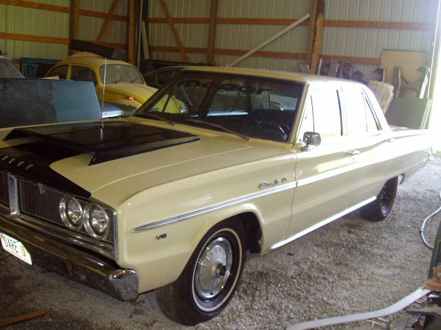

to level my 66 cornet left driver torsion bar (777) screw is almost all the way in
passenger side (776) maybe half way ( both 7/8" bars)
can i reclock driver side
