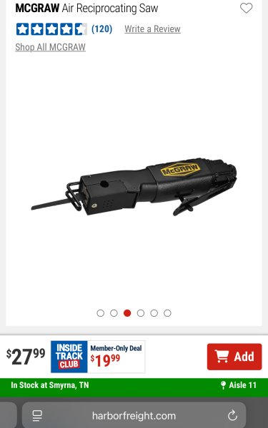

The same happened to me a few weeks ago. I used an air saw like below to cut off the rest of the bolt and the adjuster slid right out. Took maybe ten minutes.
Did you cut through the upper part of the bolt? I would think the blade would get pinched from the pressure on the upper part of the bolt?
Jack up the car and there will be no pressure. Were you trying to adjust the LCA with the car under load? That may be why the bolt stripped.
