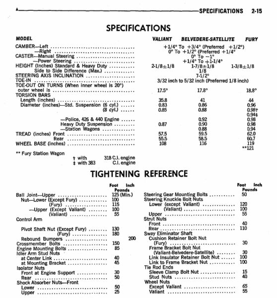

Take the car to an alignment shop. that knows what they're doing. I adjust my cars to 2" TB/Susp height, -0.5 camber, +2-3 caster, 1/8" toe-in.
Make sure your shock absorbers are in good condition. Worn out shocks make springs work overtime & the springs will sag.
Plus make sure you have the correct size bar for your weight.

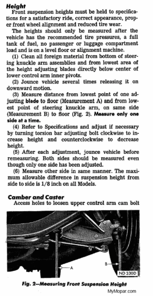

All the way up, but that will effectively be almost a locked suspension, and alignment will be so far out of range even an alignment shop would not be able to correctly set it. So, your question is rather impractical, but answered.:popcorn2:
Ride height at whatever height it is, effects your alignment.
Allan, looks like you're new to the clan. Welcome! How about a picture of your Satty?
There IS a limit ... the adjusting bolts can only go so far into the blocks until they bottom out. If the bars are too soft then you'll not be able to achieve a proper ride height.
