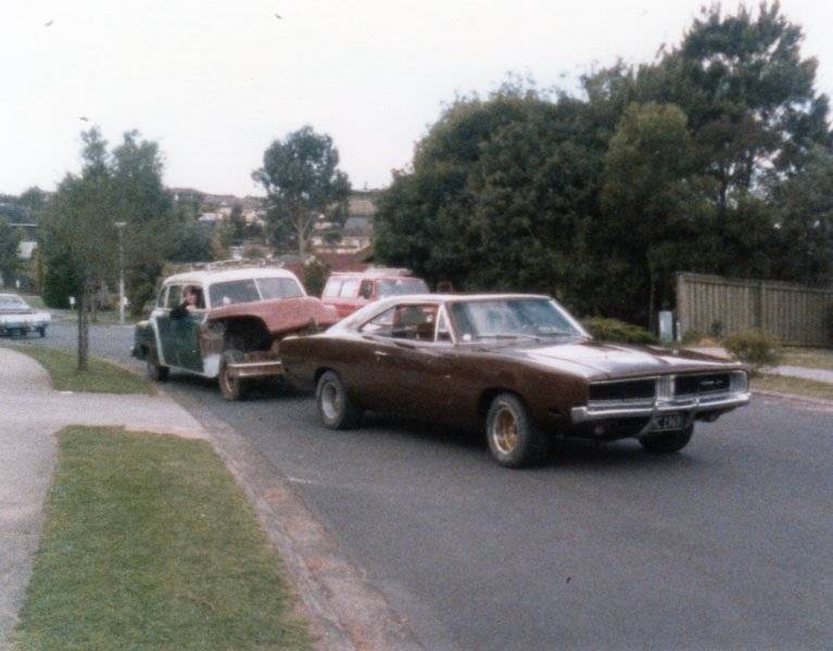

I have A-framed cars on long distances a few times over the years.
Towed this old hulk about 300 miles.
