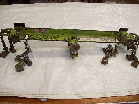

Wow, guess I've got the last one in the world.
Mine's similar to this, but square tube and can also be used as a flat tow bar, clamping on to the towed vehicle's front bumper.
...but if you're a good welder, the is usually a design with measurements in the owner's manual as stated above.
I've always been leery of how to attach them to the relatively thin C channel "frame" on our cars.
...and of course the permanent ball mount/shin smasher. I'd love to update the design to include a Reese style receiver.
Found it.
Apparently Mine was actually made (or at one time owned) by U-Haul.
universal-trailer-towbar-hitch-that-clamps-on-to-metal-bumper-50-americanlisted_34509821-jpg.jpg
That's on FCBO BTW,
I don't see the "A" frame for the flat tow use, though.

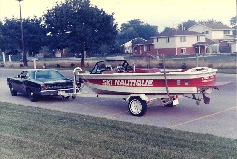

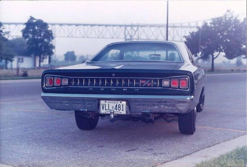

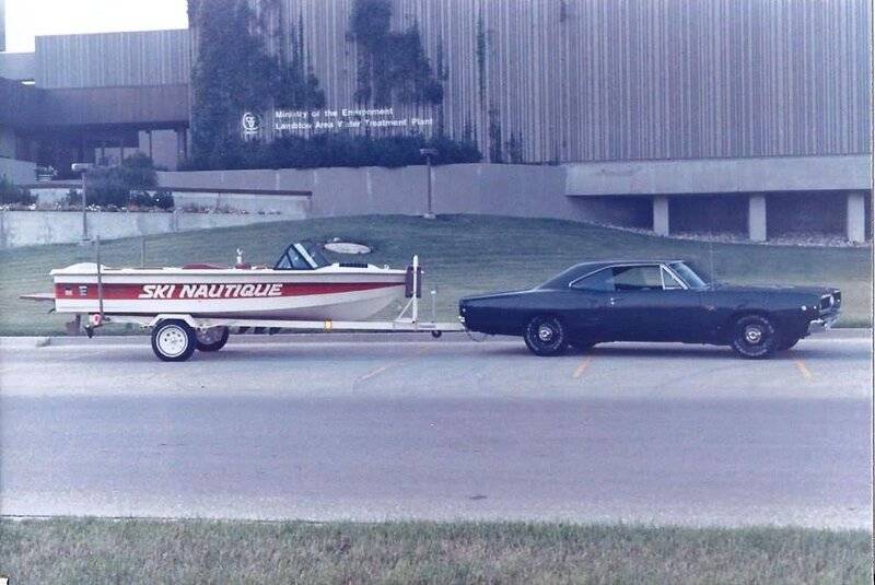

I made this hitch years ago. it was fabricated to bolt through the rear bumper, utilizing some of the existing bumper mounts. All hidden behind the license plate. Fuel filler was still functional as well. Unfortunately I do not have the car anymore, nor any dimensional information. Boat and trailer weighed about 3800#. That is a 4 speed car as well. The car is still around somewhere in Southern Ontario, but the hitch is not present in a recent photo.
