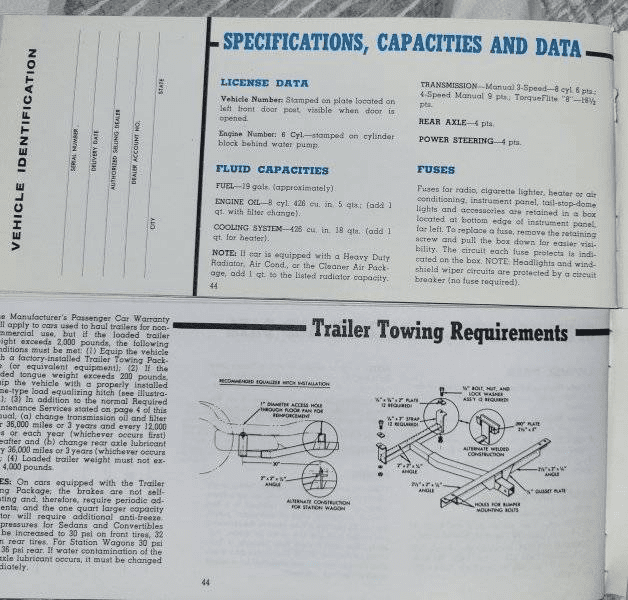

As I've said before, certain Dakota and f-150 receivers have the same frame rail spacing as 66-70 B body cars. Some grinding may be necessary.
The detail is to figure out the design vs inside or outside frame mount and which way the flange is oriented.
...then deal with the actual mounting with respect to the somewhat thin unibody rails and access to inside them.

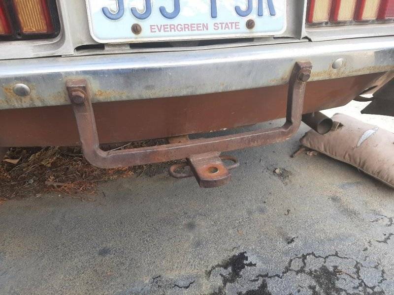

Here's a hitch installed on my 74 Charger that was on it when I bought it. I wouldn't tow anything weighing more than 1000 lbs with it. No thanks.

My GTX was used as a tow vehicle by the original owner, hauling his glider across the state when he wasn't launching from the local glider port. Dealer installed package, pictures below from the brochure the dealership distributed in 1969. Recommended weight was a ton with a B body.
Had one for a 1970 Dodge Dart stamped on it. Looked similar to yours. Sold it to a A body guy.
Factory ? Not sure.
Also my 63 Belvedere had one on it when I bought it. Looked home made with heavy angle iron from frame rail to frame rail and straps to bumper bolts like your Charger.
Terry W.
Looks like what was on my 1971 Charger also when I bought it. Still have the holes in the bumper. I used the passenger side hole for the battery cut off push/pull rod.

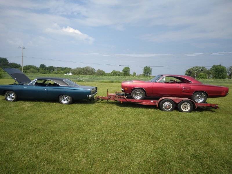

Watch Chris Birdsong on YouTube. He has a General Lee 69 charger and regularly hauls b bodies from North Dakota back to his place in Vegas. :lol:
