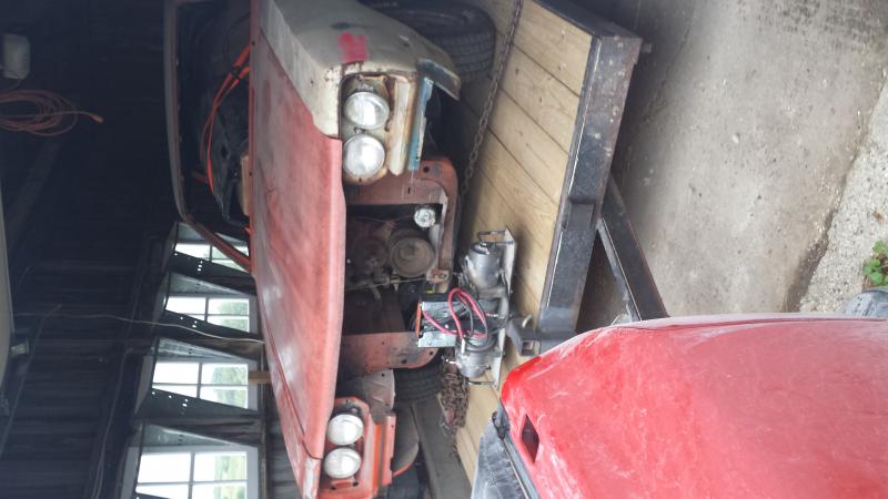

20150715_191209.jpgI use a Warn 8000#. I mounted it to a plate with a piece of 2" square tubing on the bottom. Then i welded a 2" reciever hitch on the front edge of my trailer. My winch runs off my booster box or i can reach the truck battery with jumper cables. This way i can remove the winch and store inside and i can also hook into the receiver on my truck for winching.
I dont know why my pics come up sideways......:(
