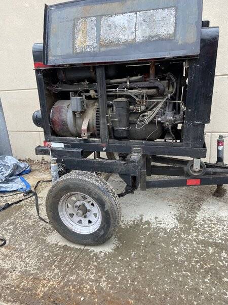

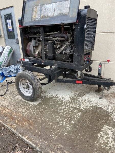

I have a engine drive welder which is about 5 1/2 foot long and maybe 2 feet wide. It weighs around 1500 lbs. Generally speaking should the center mass of the machine be over the axel? Right now its on a homemade trailer and it does not seem balanced.

I don't like the way the trailer is made, the guy who built it even commented the machine its mounted on can go 6inches forward. I don't know how to determine tongue weight but I feel there is enough weight on the tongue now but when I redo the trailer im going to move the load forward
Im also thinking of using a Eye mount and pintle hook.
When I towed the trailer the other day, I was uncomfortable even going 25-30 mph, every bump in the road all I heard was banging
The way this trailer is set up now, the machine is to high up, im going to redo and move the machine down 4 inches
I will post pictures asap and thanks again

To me this trailer looks like its made wrong. Its to short, load is close to hitch. It looks like it was made for a machine half the size.
The biggest thing I feel is the hitch is to low. I have a Tacoma 4x4 and its still seems to low for that truck....It feels like the more you raise it up past being level it wants to flip over backwards.
Notice it has a jack in the rear
