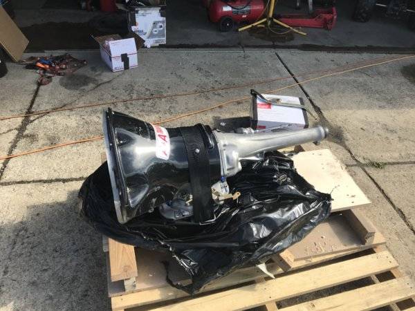

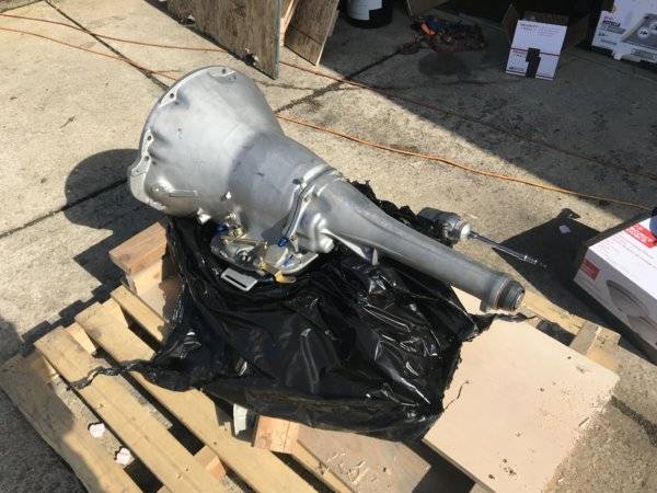

Mike, I may need to talk to you in the near future as well, just picked up an A&A super comp with a brake myself.
959A7F09-8D5E-4499-BDBC-DF12CEC2E8A6.jpeg 20B171FD-2CAE-4833-8DC9-CE307FD13D09.jpeg
