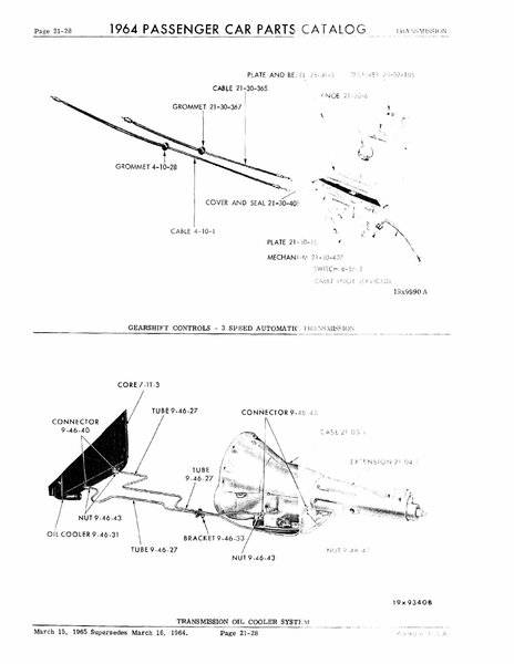

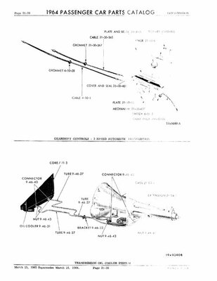

Just saw this post and my 64 Sport Fury does not have the inline filter and the lines are original to the car. I had a 63 Fury that did have the inline filter for the transmission. Just my 2 cents....:thumbsup: :luvplace:
9BFBDCAB-21B1-4C5D-9804-FC3F38984564.jpeg D7FBFBE3-AED6-4138-9F55-A4EDE5C82AF3.jpeg
Found my answer.....

It's when they went to the internal filter. The early 727 had the external filter and a mesh filter inside. The pans and valve body changed slightly also.
