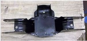

I found this picture recently - what is this for?
Any help is appreciated!

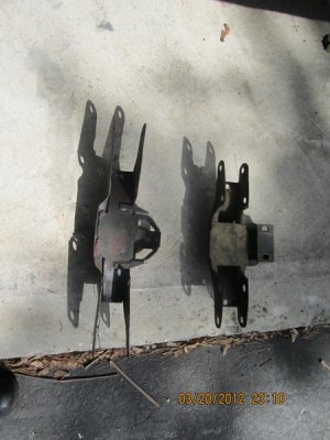

I have several laying in the garage,maybe one would fit:icon_weed:

The problem is I'm not sure which one will! I'm planning a 3 spd manual to 4 spd conversion and I'm not sure which one I need. Even conflicting info in the first two replies in this post! :eusa_wall:
