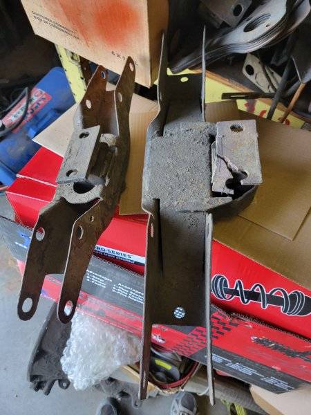

66 Ply Satellite going from 3spd manual to 4 spd overdrive from Passion. Tailstock mount location is 17 3/4” from face of trans. I don’t have in my cars anything with that far back trans mount. Checked Duster, Roadrunner, Cuda. Any idea what tailstock is on this trans? Thanks
The trans on the left needs an automatic crossmember, and the one on the right needs a 66-69 four speed crossmember.
Thank you It is going in a 66 3spd manual and the parts manual has a different part number for the 4 spd. The left one is a spare for 70 B and E body non overdrive. Jamie Passion just called me back and confirmed what you said and has the correct mount. I am picking it up at his place Saturday. I have 3 66 67 cars but all auto on floor. 1 66 3 spd std. all have same trans mount. I never saw a 4 spd mount. Thanks again.
