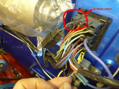

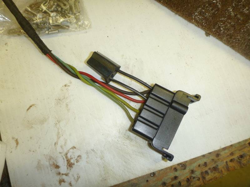

This is the pig tail they are talking about...
This is on my '69

Yep,... That's it. Like Flypaper said,.... I wouldn't have thought the wiper motor would be different wiring for manual vs auto transmissions. What the heck does the transmission have to do with the wiper motor?
What is that extra pigtail used for? Since I am converting mine to 4spd, I'm wondering if I need that and what it is for?

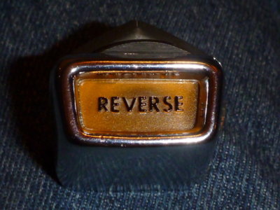

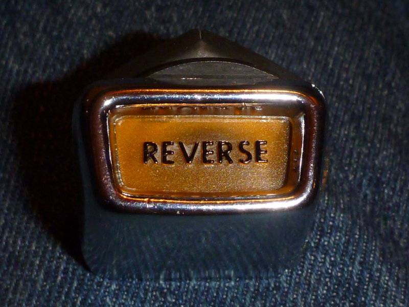

They are specifying trans so they send you the correctly wired bulkhead connector as I've shown. That pigtail connects to the reverse switch on the trans. Inside all it is doing is lighting this...

..BUT most importantly it's putting your reverse lights on!.. although I believe that is via the jumper wire in my hand in the picture in post 3
Thanks. Sounds like I need to make sure I get the right wiper motor with that added pigtail then. Makes sense then since the reverse light for manual transmission is on that portion of the bulkhead connector, you would have to account for those wires.
